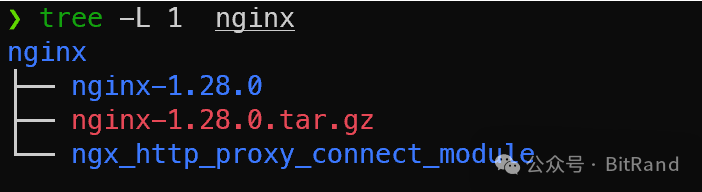

# 开启https代理需要打补丁cd nginxgit clone https://github.com/chobits/ngx_http_proxy_connect_module.git
cd nginx-1.28.0# 根据github介绍材料中的版本兼容,选择合适的补丁文件patch -p1 < ../ngx_http_proxy_connect_module/patch/proxy_connect_rewrite_102101.patchsudo ./configure --with-stream --with-http_ssl_module --add-module=../ngx_http_proxy_connect_modulesudo make install
