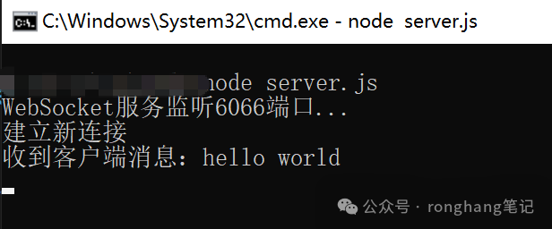

  2. 搭建WebSocket服务,server.js:
    const { Server } = require("ws");
    const server = new Server({ port: 6066 });
    console.log("WebSocket服务监听6066端口...");

  3. 启动服务 node server.js

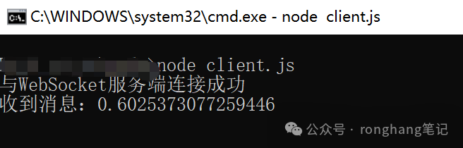

  4. WebSocket客户端,client.js:
    const WebSocket = require("ws");
    // WebSocket连接nginx代理服务器192.168.1.18
    const socket = new WebSocket("ws://192.168.1.18:6066/");
    socket.on("open", () => {
      console.log("与WebSocket服务端连接成功");
      socket.send("hello world");

  5. 启动客户端,node client.js
